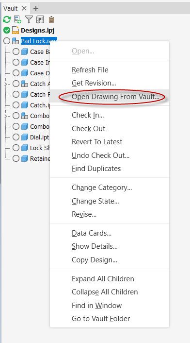

@m.verbroekken Hi Thanks for posting the idea. We always recommend to open the files inside the CAD application. So in Inventor we have that "Open Drawing from Vault" command. Does that work for you? if not, why? Thanks.OpenDrawing.jpg

I am aware that Inventor offers that option, sadly it doesn't cover my current issue.
The reason I'm suggesting this functionality is because i repetitively need to update the title block of multiple .idw's.
Opening the part and then the drawing is at first time consuming and it also eats up a ton of resources on the machine.
Thanks anyway for your suggestion.
