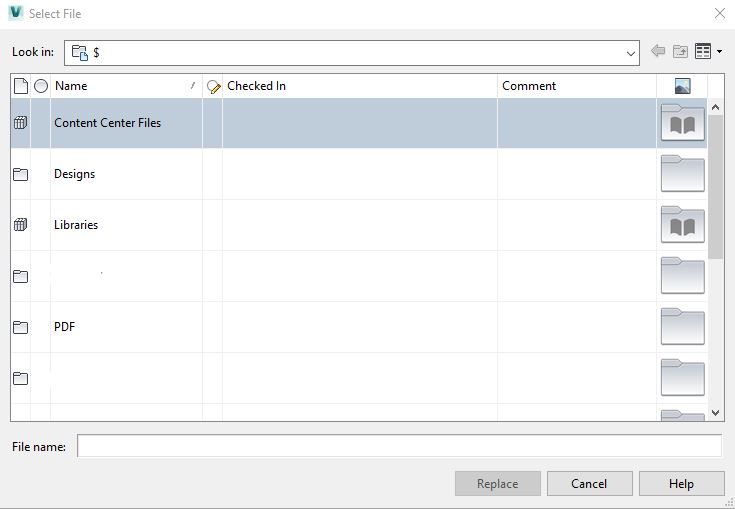

When opening the Select File Dialog during Replace, include a full functioned search.  Currently only filename is supported.

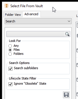

Marina Collet made a nice picture of how the search could be integrated in the "replace" UI.

The selection file process for the Replace tool during a Copy Design operation can be improved.
It has 2 major problems:
1) it doesn't have a Search Tool, and you have to browse the whole tree folder in order to find the file you are looking for
1) it forgets the last used directory, and you always have to restart from the beginning. If you have to Replace more files in the same Copy Design operation, this is very annoying
