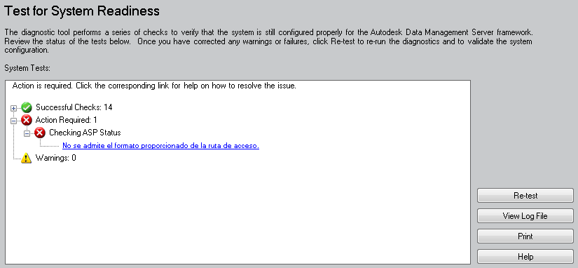

I have a clean backup. So, I've uninstalled everything about the old adms 2012, SQL server to make a clean installation.
I also have ran the "Scripttool.exe" and solved some errors but still have one that I can´t solve. Please see the attached image.
Message: "Checking ASP Status    The given path's format is not supported."
Regards.

JamesMcMullen
If you attempt to browse to the location listed in the link, does the file exist?  Based on this error and the one you mentioned above, I am thinking that there is something wrong with the media.  But, let's make sure that is the case.

Message 7 of 23
Yes. The files are in the media but with a little difference in the path.
The setup ask for:
D:\INVENTOR 2013\x64\ADMS\Program Files\Autodesk\ADMS 2013\Tools\TestASPNet.msi
instead the "TestASPNet.msi" files exists in:
D:\INVENTOR 2013\x64\en-US\ADMS\Program Files\Autodesk\ADMS 2013\Tools\TestASPNet.msi
The variation in the path is the "en-US" folder.
So. I've decided to copy the files into the path asked for the setup and now I got the nex message:

Message 9 of 23
Thanks Jim.
In fact. The machine has an Spanish OS, and the install media is an english version. The media was downloaded from the upgrade link of the e-mail sent by Autodesk. So, I´ve installed the Suite for inventor but still I can´t setup the Vault server.

Message 10 of 23
JamesMcMullen
Can you try switching the "INVENTOR 2013" to "V_Server"?  Also, what happens when you run the MSI directly?

Message 11 of 23
I switched the "INVENTOR 2013" to "V_Server", and ran the Scripttool and remains the same message.
Then, I´ve ran the MSI file and the message changed to:
Also I´ve looked the IIS manager and this is the state:
