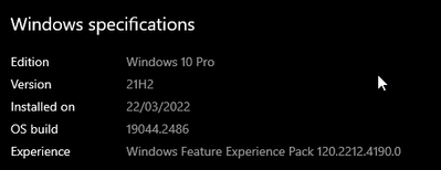

I have a customer having this also happen to them and they are using Windows 10 with Vault Pro 2023.2. The exact same issue happens, you can view the files in thin-client and in Vault with ADR but not within Vault using Autodesk Viewer. We tested on multiple files with the same results.

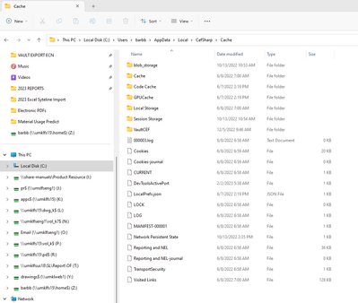

1)In user's machine Clear cache:  "C:\Users\%user%\AppData\Local\CefSharp\Cache"

On step one, are you saying delete all of the files under the Cache Folder? There's a bunch of folders and files...

While deleting entire folder will not really harm but this is a common library that could be used by other applications too. So if you delete the entire folder - you may loose some settings etc for some other applications too.
