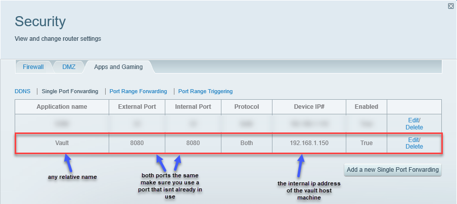

you need to log into your router and forward the port. To get your router address, you can open a CMD prompt and type in IPCONFIG. The Default Gateway in your router ipaddress
log into your router using the ip address (check with your ISP,usually it on the router or in the booklet). Look for port forwarding, i have a Linksys router and my PF is in Security/Apps/Single Port Forwarding. It should typically look like this (or very similar)
You add a new port forwarding with external / internal port, protocol = Both and the ip address of the machine hosting Vault.
in your IIS ADMS site bindings along with the 3 files you called out, the IP address needs to match the forwarded port. 443 is typically SSL, is that what you want? Vault is behind its own firewall & WD firewall. Im not sure if 443 would give you issues as its SSL
Lastly, the address that gets you connected. Internally on LAN, you should be able to use the machine address or Localhost easy enough because thats all internal on the same network but remote is different, you will need an external point of reference (public ip address) to get to your network.
If you have a staticIP public address, its much easier as that remains the same always otherwise you may need to use a DNS server like dynDNS.

so, once everything is set up as above, the connection methods work like this (StaticIP as example)
  • Vault Client server = 56.132.55.254:8080
  • connection attempts to reach ip address 56.132.55.254
  • connection is greeted by Router and router wants to know what you want / where you want to go
  • the port number is the answer :8080
  • Router sees that, sees that there is forwarded port for 8080 so directs you to that port
  • at the end of that port is the Vault machine
  • ADMS in IIS is waiting on port 8080 for any incoming traffic
  • IIS picks up the incoming traffic, sees that its ADMS and directs you to the ADMS site
  • ADMS webservice establishes connection & credentials with the incoming traffic and grants access
  • Vault Client establishes connection to Vault Server
Hope that helps

@NachoShaw, I have no words to thank you enough for such a brilliant and detailed information.
However, (yes there is a "however" 🙄) Still struggling to connect.
I'm going to play a bit more with it and will come for more help tomorrow 🤦🏿‍♀️.
You mention that Port 443 may give some problems? I only selected that one because it is the one mentioned on the document from Autodesk.
I tried modifying all the .config files and IIS bindings to Port 8080, but it wouldn't work, not even local clients.
Like I said, I'm going to give another go, and hopefully, I'll be back here tomorrow to say "Thanks!" again because I finally got it 🙂
