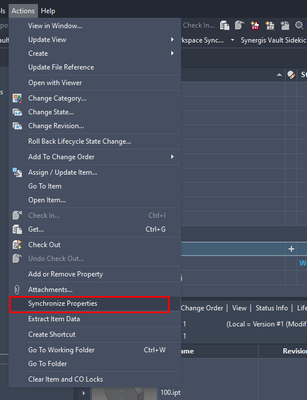

Not a workspace sync. That is doing nothing other than checking the files you have downloaded locally in your workspace on your PC compared to Vault. You need to do a Synchronize Properties on the file to check it within the Vault...select the file, go to Actions>Synchronize Properties

Thank you, but no change in displaying them.
