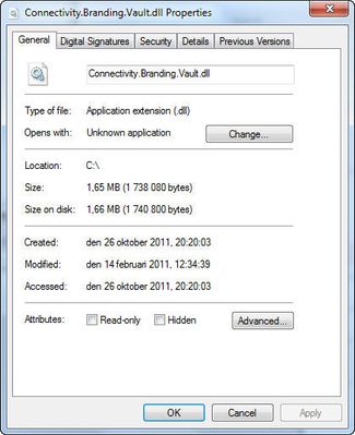

5. Next I try to install the Update 1 but "sorry to say" the same error-message as above displays when patching Connectivity.Branding.Vault.dll.
6. To be sure nothing was different with the file Connectivity.Branding.Vault.dll between suits I also downloaded FDS Standard to compare the file but it was no difference.
7. I´ve also tried to install the update at our office (Windows 7 x64, the customer has Win 7 x86) but the same error message appears.
This is the properties of the file:
Properties
Hope you have some more ideas how we can solve this.
Regards
Per

Can you try replacing the "Connectivity.Branding.Vault.dll" file located in your "C:\Program Files\Autodesk\Vault 2012\Explorer" with the file attached to this post.
Let me know how it goes...
If you find my response solves your question, please click the "Accept Solution" below the response
Richard Rankin
Vault Support Specialist
Global Product Support
Autodesk, Inc.
Message 12 of 50
BL4849
That worked for us here.
