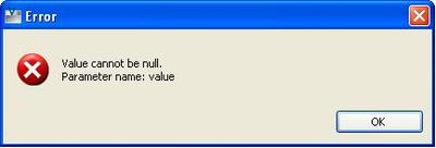

Hope someone can help me with the following:
During copy design in Vault 2012 (Inventor 2012) I get an error: Value cannot be null; Parameter name: value
None of the files are copied. I've tried al kind of different ways, coping in the same folder, different prefix and/or suffix, first selecting files, folderlocatin in "To", other way around, no folderlocation in "To', and so on! I've also contacted our Autodesk supplier, but till now do they also not know what causes this.
Does anybody know what can cause this or better, has a sollution for this?

It looks like there is a permission problem with your filestore directory.
The server runs as a particular user (by default "AutodeskVault"), and that user needs full control of the filestore directory.

I've been cheering to early, it worked with one part, but not with compleet assemblies (idw, iam and ipt), I got the same error as before.
Also no-one did delete the user "autodeskvault" (which I thought before. My supplier told me it is a known problem at Autodesk and are working on it.
I know the user "autodeskvault" was there before I installed 2012 over 2011. I don't know if it was deleted on the installation of 2012.
Still, I've reinstalled the Vault Server 2012, but with no change.
Also, we hade to upgrade the SQL from 2005 to 2008, could there be the problem?

No, till now they didn't go away after giving autodesk user full control. To be sure we also have restarted the server after reinstalling Vault server, but nothing changed.
Straingly enough I can copy design a single file, like a idw, iam or ipt, as soon as I select multiple files, as a iam with its ipt's then it goes wrong.
There must be something wrong with the installation of 2012, 2011 worked perfectly!
We had to upgrade from SQL2005 to SQL2008 because of 2012 installation, perhaps something went wrong there.

Hi Dave and Jeremy,
I've checked and rechecked the permissions for user "autodeskvault" and made sure it has full access to al the folders.
It did not work.
Next I've restarted the server on which Vault Server works to make shure everything works correctly.
Still doesn't work.
What I do not understand, is that it is possible to copy design a single file (makes no differents between iam, ipt or idw), but as soon as I want to copy design multiple files it goes wrong.
I also made a totaly new testpart and assembly in a sepperate folder. Checking in and out is no problem, but copy design stays the same error, only once I had one other error (in Dutch):
Exeption of HRESULT
Exeption of HRESULT: 0x80004005 (E_Fail).
I tried this new part and assembly also on other computers (Windows XP, Windows 7), but copy design stays the same with the error:

Would you please send a screen capture of your Administration>Vault Settings>Define Working Folder dialog please?

Hi Dan,
Try changing your working folder to "c:\designs"
That fixed mine. I had 'c"\" as well.

Below is a recommended configurtion for setting up defined working folders.  We have discovered that having the working folder set to C:\ is the issue at this time.  Please set up a workking folder structure similar to the below link along with a new IPJ, restart Vault Explorer and test.
