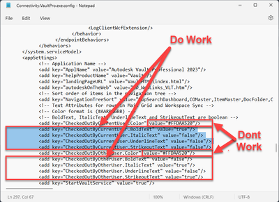

Vault has now got a dark mode which is great as it looks more inline with how AutoCAD and Inventor Dark mode look but there is a little issue with color choice.
When you have a file checked out the default color is Bold Dark Blue, and Dark Blue on Dark Grey on some screens makes it difficult to read easily, I was wanting to change the "CheckedOutByUser" color to Gold as this would probably look easier on the eyes. There is an old post which shows describes how this can be done.
Now if I edit the config file the only mode that honors these "Color" settings is "Classic". Dark and Light "Themes" seem to ignore it, is there another file I need to edit to get the font colors to change?
The really strange thing to me is that Vault follows all the other options like "BoltText" and "Strikeout", it is just the Color value that get ignored.

Senthil_Kumar
@JonathanKruger Thanks for posting this issue. The Dev team confirms the issue and looking into fixing this in the future updates. Sorry for the inconvenience.

jpeters9XH3R
having this issue as well, has this been addressed at all? currently using Vault basic 2023

Message 6 of 9
jpeters9XH3R
Hi I don't seem to be able to follow the links through to the knowledge document to try fixing the issues in vault basic 2023
Message 7 of 9
Senthil_Kumar
Sorry. The link seems to be broken. Here is the Link to the right article.

jpeters9XH3R
That's fixed it thank you.
