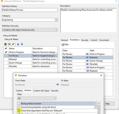

It seems you try to release an Inventor drawing that has a non-released assembly on it from your screenshot.
I assume that the lifecycle your drawing is in requires child files to have the released state when you try to transfer it, and that the mentioned assembly is not in such state.
Could you verify if the following setting is similar in your environment for your lifecycle transition?
Best regards,
Bastian

@bastian.estner  thanks for the reply.  You are correct, the check box is selected.

The point of this flag is that it indicates if the file is in a "Released State".
In other words, when you try to release the top assembly, Vault checks if this flag is active for all subassemblies and parts.
In your screenshot, this is not the case.
Therefore, the transition criteria mentioned earlier to check if child files are released will result in the error you described initially.
If you want this criteria to stay active, ensure that all components are in states that have the "This is a Released state" active.
Practically, you could use the view you've created to identify all components (subassemblies and parts) that are not meeting this criteria and move them in such state.
Afterwards, you should be able to release the top assembly and its drawing.

Is the point of the flag in the control tab of the lifecycle definition page to allow someone to name a state that acts like a "released" state something else?  You could have a state called "complete" but in order for the vault to treat it as a released state, you would have to have this box checked.

The scenario you are describing is one reason for this flag yes. There are others that can be found in the product help here: http://help.autodesk.com/view/VAULT/2021/ENU/?guid=GUID-02294D64-9ACA-4546-956E-095D9D7814B1
Your conclusion regarding your issue is exactly what I would expect as well with one addition: You could release the top drawing and assembly together with all non-released files in one process as well.
