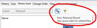

@ihayesjr @CGBenner
I was still having issues with this and I found it annoying not being able to open from the "Uses" and "Where Used" tabs. One thing that I noticed is that the files that were giving me problems had the Work in Progress life state. I was able to solve my issue of Inventor not locating the versions by changing the state of my iparts to "Released". Now when I open from the "Uses" or "Where Used" tabs, I do not see any errors in Inventor.
I really think there is an issue with the "Non-Released Bias" and "Released Bias" tool because it made no difference when I was working thru this.  It seems that what I needed was the "Non-Released Bias".  Maybe I don't understand what this tool does.

ihayesjr
@karthur1
The Released\Non-Released Bias button only effects the display of the grid, not how the files are opened from that grid.
