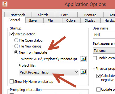

I got sick to the teeth of users complaining to me they couldn't open from Vault, Vault is broken, Inventor is broke, but it was just their IPJ being reset to Default.  It happened every day to random people.  Drove me nuts.  So what I did was go into the Inventor application options and forced their Inventor to load a new IPT on startup which in turn lets you set the IPJ to the Vault one:
So essentially, whenever Inventor starts up, it will go directly to making a new file and set that IPJ as active.  This annoyed the users because Inventor took a little longer to open up, but zero f**ks were given by me as I was annoyed at them being unable to figure out their Inventor was using the default.ipj
You can then embed these application options into your deployment image so when installed, you annoy ALL users.  This makes me happy. Cat LOL
