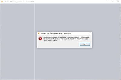

I'm running Inventor 2020 with the vault 2020 running on localhost (currently one user). All latest updates are installed.
During the weekend I renamed my computer, not knowing what the effect was for the vault server.
Now when I try to start inventor or vault I get this error message:Vault Error.jpg
Then I tried checking ADMS console. This gave me this error, which closes the program when OK is pressed.

JamesMcMullen
Hi Alex,
The command that you executed is to help you with the syntax as Yogeshwar was mentioning above. The best way to get that information is to execute a couple commands in the Microsoft Command Prompt (mainly the program you used to execute the command line).  Once you have that open, let's try the following:
1. Get the original server name
   a.  type in "SQLCMD -S localhost\AUTODESKVAULT"
   b.  type in "select @@servername
   c.  type "GO"
   d.  (write down somewhere the name that it returns since this will be the SNO option)
   e.  type "exit"
2. Get the new server name
   a.  type in "hostname"
   b.  (write down somewhere the value returned here since this is your SNN option)
At this point, execute your original command you called out in your original post.  Unfortunately, I have no way of helping you getting the other information the command executes.  For the DBU and DBP, our example assumes the defaults.

alex.evers
Hi James,
Thank you! That fixed that issue.
Only now a new problem arose.. The new server name is not a member:
I then tried logging into ADMS, which gave me this:
How can I add the server to the list?
Many thanks!

gandhey
For the error seen with ADMS launch, I think you need to set/change the SQL user account password. You can do so by accessing the sql server instance using SQL Server management studio.
https://knowledge.autodesk.com/support/vault-products/troubleshooting/caas/sfdcarticles/sfdcarticles...
Regards,
Yogeshwar
(Vault team)
Message 11 of 11
alex.evers
Yes! I got it:
I installed Microsoft SQL server management studio, the login wasn't there so I created it with the same name and mapped it to my Vault database.
