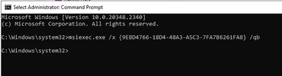

Updated below for removing Vault Data Standard from Vault Pro 2025
1. Close all software
2. Start Command Prompt as Admin
3. Type the matching command for your version of Vault Data Standard
msiexec.exe /x {9EBD4766-18D4-48A3-A5C3-7FA7B6261FA8} /qb
4. Press Enter and wait till it is done uninstalling
If this solves your issue please mark this posting with the "ACCEPT SOLUTION".
If you like something that was said or if it was helpful, Likes are appreciated. Thanks!
