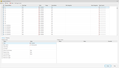

In Vault we had a bunch of properties that were added in and searchable making a huge mess.  I've since gone through and disabled the majority of the properties making the property selection screens in Vault much cleaner.  However I noticed that when I want to add a property to view in the Vault Browser Pane in Inventor, it still shows all properties that I have disabled.
Vault:
Disabled properties no longer appear in Vault
Inventor:
Disabled properties still show up here
Is there a way to remove the disabled properties from this list or do I have to go through the longer process of deleting those properties from the Vault?

See if changing the "Requires Value" to True in Vault helps:
https://resources.imaginit.com/data-management/deleting-stubborn-vault-properties
pmartick
That post will be helpful if the solution is to indeed delete the properties. I'm guessing there isn't a solution to this other than to submit to Idea station to make the Add-In selection field synchronize with the property selection in Vault.
