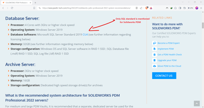

You can also refer to Solidworks PDM System Requirements which doesn't even mention SQL Express. Even our Vault System requirements must not mention SQL Express. This is a kind request to the Autodesk Vault Team.

While I understand the request, putting SQL limitations in the system requirements wouldn't be something we would do. Just as your example from Solidworks, while they don't use SQL Express, SQL Standard does have limitations which they don't list either. As Microsoft could change their limitations at any time, we don't want to keep changing these pages to every time they change their requirements.

This is Solidworks actual website listing their system requirements. It makes no mention of SQL editions or limitations.
System Requirements | SOLIDWORKS
I will add a line item at the bottom of the 2025 system requirements recommending that you look at Microsoft's website for SQL information. Like previously stated, I am not going to list specific as Microsoft might change them at any time.
