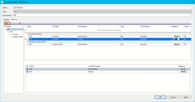

I configure "JobProcessor.exe.config" and use the following (I verified that this works):
<add key="DesignRepresentation.Naming" value="\.(idw)$/&lt;_name_&gt;-&lt;Revision&gt;-"/>
The "Part Number" property is for an ipt or idw files. It does not exist as a system property in Vault so I had to make it, meaning that "Part Number" is User Defined Property.
I tried the following with no luck (I just get the filename.idw.pdf):
<add key="DesignRepresentation.Naming" value="\.(idw)$/&lt;_name_&gt;-&lt;Revision&gt;-&lt;Part Number&gt;"/>
It works with the property "Author"!
I created a property called "PartNumber" and mapped it in the same way as "Author", and still could not get the Job Processor to generate a PDF with the "Part Number" property in the name of the PDF file.
I am running Vault Workgroup & upgrading soon to Pro.
Thank you in advance 🙂

TSAS24
First:
Exist Inventor & the Job Processor
In Vault, map Part Number to "Project".
NB! Remember that (all) files in Vault has this property, so a reindexing of the Vault will occur!
Search for: Property Compliance - is - Pending to see which files are getting updated.
As admin, edit JobProcessor.exe.config
~C:\Program Files\Autodesk\Vault Client 20XX\Explorer
Filename-Revision Number-Project.pdf
<add key="DesignRepresentation.Naming" value="\.(idw)$/&lt;_name_&gt;-&lt;Revision&gt;-&lt;Project&gt;"/>
Now make sure that when you add a Part Number to a new file, the Property "Project" will get the same value as Part Number.
Start the Job Processor, run a lifecycle on a file and make sure that the Job Processor produces your desired format!
Mine is: Filename-Revision Number-Project.pdf
Everything works? No -> find another topic
Yes -> Continue here:
Quit the Job Processor (& Inventor)
Edit JobProcessor.exe.config
MANUALLY "NO COPY/PASTE" Change:
to
It works for me now 😄
