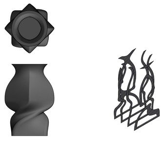

The colors on the PDF from the job server and the PDF made manually through Inventor are different, see attached PDF's.
The Job Processor version has darker colors and no gloss/shine/reflection(?).
The manual version is how we prefer it.
For this test, the job processor is running on the same workstation as were we manually made the PDF.
If anyone has ideas, i'd be glad to hear it.

Find attached the part, drawing and the server design data folder. Due to file size limitations i am not able to also include the local design data folder.
The Design Data (server) is the entire design data folder packaged from the Vault server location. This location is also referenced in our project file.
The Design Data (local) is the entire design data folder packaged from the local location "C:\Users\Public\Documents\Autodesk\Inventor 2020\Design Data". This location is set in the Inventor settings.
Before i tested again, i deleted the local design data folder entirely and copied the server folder into the local variant.
When i opened inventor and set the design data folder (in inv settings) to the local folder as seen in the picture above, it gave a prompt that not al required file were available and if i would like to download them from a source(?). it then promptly downloaded some files from our \\vaultserver.xxx.local location (the server design data folder).
i am not able to reproduce this notification.
Below another comparison of the job server PDF (Left) and the Manual inventor export to PDF (Right)
