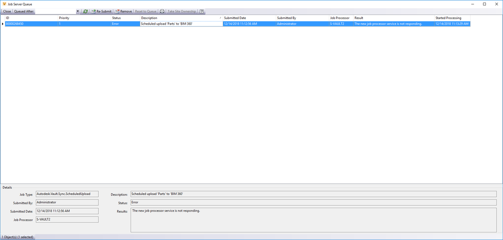

As a note, I attempted another sync over the weekend and resulted in another error.12-17-2018 8-25-19 AM.png

When you logged into the Job Processor, did you log into it with both your vault credentials and cloud credentials.  In particular, your cloud credentials should have write control over the location you are attempting to write too.
Jim
James McMullen
Principal SQA Eng.
Message 20 of 22
mmaes
Hi James,
Yes, I am logged in both in the job processor with my Vault ID and into the cloud with my Autodesk ID.  I believe that is what you are asking.  Also, I have admin rights for both.
