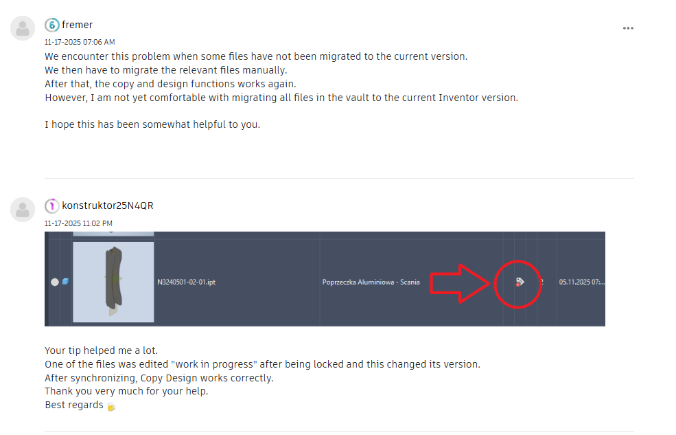

Good Day,
we have a problem with the copy&Design feature in Autodesk Vault 2025.
In some cases when we try to copy some files we get the Error:
"An element with the same key has already been added"
I tried to update the files manually and do the copy again, but this doesn´t work...
When i open the files in Inventor i cann copy them as usual but i need the copy&design feature for larger assembly...
Does somebody has a workaround for this issue?
457 Views
konstruktor25N4QR
Hello, I have the same problem in my version of  Vault 2025.
This message doesn't always appea, but always with the same IAM files, I have no idea what could be causing it.
I really want to fix and explain this mystery.
konstruktor25N4QR
Solution
