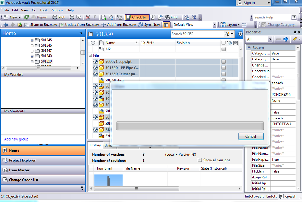

have assumed this is being done all from within vault and not from inventor, so far its looked like below for about 10 mins and counting!
this is step 1.
Message 6 of 14
ihayesjr
You should be performing check-in of Inventor files using Inventor, not the Vault client.
