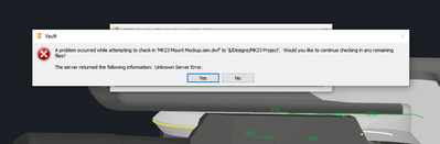

Cannot Check In Assembly File - Unknown Server Error
Lobos8403
Noticing this error on some of my files.  I recently updated to Vault Server 2021.
The message reference above is coming from the workstation that has vault server installed and is acting as the server.
My laptop will not allow me to open the same files when attempted to open from the Vault.
Was there a step i missed somehow when updating?  This only occurs with a seemingly random files, others can be checked in/out with no issue.

Hi @Lobos8403 ,
the error tells that the .dwf files cannot be checked in. What if the dwf creation during checkin is disabled?
Will it check in fine?
Also: please also take a look at the Vault server logs on the time where this error occurred.
This might give us more details on the issue.

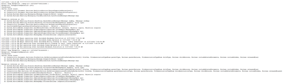

Lobos8403
This is what the server logs are saying.
Message 4 of 10
Kevin.Jaufmann-Ludwig
Autodesk Support
Autodesk Support
So this entry in the log occurred on the time where the checkin failed?
If so this will not really help.

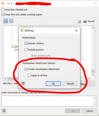

cbenner
@Lobos8403
Hi...  when you are checking in the assembly, this option can be found here:
It is based on the visualization settings in Vault.  See if you can check the files in with this disabled.

Lobos8403
I tried this.  Only one error message appears instead of the two now.
