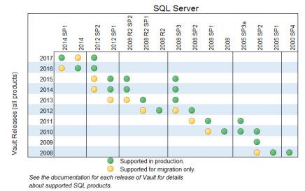

Well if this is a new server there are some gotchas that you have to watch out for.  Not sure if this will solve your problem, but it is worth noting.
If you installed the SQL instance before the Autodesk Installation you have to be aware that your version of SQL is compatible with the version of Vault you are running.
You also need to make sure if you did pre-install SQL that you set the compatibility to 2008 and did not leave it at 2012 or 2014.  This isn't documented very well, but the database needs to be at that compatibility level.
If you are using SQL Express that comes with the Vault then you can use what Vault automatically installs, but if your old server is using a licensed version of SQL you should stick with that as your amount of metadata may be over the threshold for SQL Express.
What is your current server running and what is the new server running in regards to SQL?  What is your database size at right now from your old server's ADMS console information?

Message 14 of 14
Hi Jim
It worked, deleted the vault, in SQL and I was able to delete the bad vault.
Thanks. 🙂
