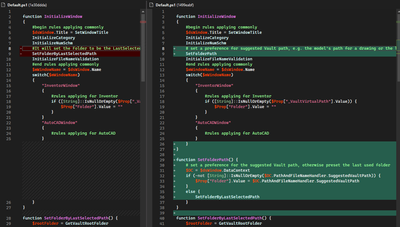

Update 3 resolved the regression of Update 2 and presets the model's path as a drawing location. The changes in the script are highlighted in green; you can change your configuration in this area.
I hope this answers your question.
- drawings that re-use the model's number as a file name preset the path to the model's location rather than the last used folder.
- if you prefer to re-use the last used folder in any case, you can remove the suggestion and strictly call 'SetFolderByLastSelectedPath'
