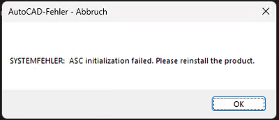

I have a problem where my job handler, which starts AutoCAD, cannot create a new instance of AutoCAD after updating from AutoCAD 2026.0.1 to 2026.1.
I explicitly created a new job handler that only tests the AutoCAD startup to avoid any interference with other code. Unfortunately, I always get the same result.

when this line of code is called...
_Acadreturn = (AcadApplication)Activator.CreateInstance(AC, true);
...this AutoCAD error message appears.
The exception contains this message
Retrieving the COM class factory for component with CLSID [607BBE5B-A4EE-47EB-88C9-75FE5F12EAC7] failed due to the following error: 80080005 Starten des Servers fehlgeschlagen (0x80080005 (CO_E_SERVER_EXEC_FAILURE)). : at System.RuntimeTypeHandle.AllocateComObject(Void* pClassFactory)
However, the same code works fine from a console application. So it must be something in the job processor environment.
I have installed all updates for AutoCAD 2026, Vault2026, and all installed Autodesk products.
Does anyone have any ideas?

Hi @gbadziura : Vault 2026 Update 1 included an updated SDK; the change reflects newer licensing libraries required for Autodesk applications consuming the same. Your console app might not run into this conflict, whereas a custom job likely does. I suggest installing and referencing the SDK 2026.1.

This is not about the Vault 2026.1 update. I have been using it since it was released. The problem only occurs when you apply the 2026.1 update from AutoCAD.
As I said, everything works perfectly with Vault 2026.1 and AutoCAD 2026.0.1. Vault 2026.1 and AutoCAD 2026.1 do not work!
Furthermore, I do not supply Autodesk DLLs. Whatever the client has installed is used.
So I don't understand how licensing could play a role here. The only thing that has changed here is AutoCAD.

Hi @gbadziura, now I got you. Please submit a support ticket.
