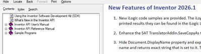

Keeping track of API changes for Inventor is easy since the API guide is directly accessible from Inventor and the What's New section details changes in each annual and patch release:
etc.
Requiring us to find and install an SDK to then find the API Guide to Vault is completely unnecessary in my opinion. I understand a separate installer for templates and such but not for the guide. It should be directly accessible from Vault just like Inventor. The Vault SDK API guide also doesn't detail updates in each patch release as far as I can tell, just annual release differences.
