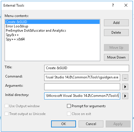

ron_m
Did you get it to work?
Reusing my GUID should not cause a problem on your system unless you were to register my version of the dll.
The tool is in C:\Program Files (x86)\Microsoft Visual Studio 14.0\Common7\Tools\guidgen.exe on my computer.
You may need to download and add it to using External Tools.
See the attached
