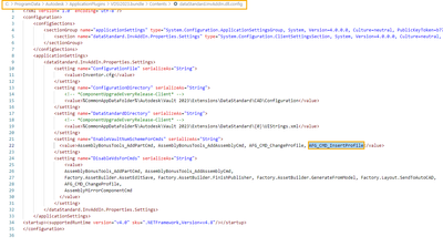

To disable VDS Frame Generator dialogs, you better rename or remove the file FrameGenerator.xaml. To avoid the VDS temporary file names for member files, you should enable Vault numbering for FG. Add the command AFG_CMD_ChangeProfile to the configuration file as shown below:

I have not seen any differences when editing dataStandard.InvAddIn.dll.config with that configs. What was suppose to happen?
