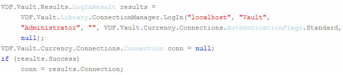

Thanks, Gavin.  Can anyone provide me with the vb equivalent of the following C# code?

Gee, I haven't done any VB in ages but...
I think it'd be:
Dim results As VDF.Vault.Results.LoginResult
results = VDF.Vault.Library.ConnectionManager.Login("localhost", "Vault", "Administrator", "", VDF.Vault.Currency.Connections.AuthenticationFlags.Standard, null)
Dim conn As VDF.Vault.Currency.Connections.Connection = null
If results.Success Then
         conn = results.Connection
End If
You'll need to set up the namespace alias for VDF. Usually VDF refers to the Autodesk.DataManagement.Client.Framework library.
If you haven't used the VDF, start here: http://knowledge.autodesk.com/support/vault-products/learn-explore/caas/CloudHelp/cloudhelp/2015/ENU...
If you can't get it to work, explore one of the VB.net code samples in the Vault SDK folder.
