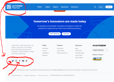

I'm replying here because I've been looking for an HOUR where to provide suggested improvements to Tinkercad.
First, sure seems the Autodesk Community as it relates solely to Tinkercad is woefully convoluted, complex, and complicated to new users.  I found Reddit and Facebook almost instantly but forums and the interface in Autodesk are a horror show IMHO.
Now to my humble suggestions: I realize Your Creations has "tags" and "search".  But seems it would be very helpful to provide folders/subfolders to stick creations in.
Also, seems in Basic Shapes it would be helpful to have a few premade "knives" (cleaver, butcher knife, paring knife..) to cut off or trim portions of a model.  A real PITA to repeatedly have to use a rectangle and resize for a simple cut.
Finally, maybe a warning in Your Creations that if you put something in there that is a combination of shapes, you cannot thereafter take them apart.  I spend several frustrating hours trying to figure out why I could not do this before finding an obscure comment from a user somewhere.
I also realize Tinkercad is free and cannot be as robust as Fusion 360, etc., , so I'm not looking a gift horse in the mouth.  Truly a wonderful program and gift to us.  Actually the BEST hands down for what it does.

@carwellbob wrote:
I'm replying here because I've been looking for an HOUR where to provide suggested improvements to Tinkercad...
Sadly your post will go slowly here with the TinkerCAD team: add your feedback where they look for them:
https://www.tinkercad.com/
