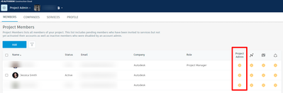

jessica_smith
@nir_arad_79 sure. So your permission level in Autodesk Docs is factored in when accessing files (models, pdfs, etc.) from the Docs project via the model upload and docs dialogue box in Tandem. To upload files from the Docs project to Tandem, you need administrative access to Docs. This is by design. Picture below of where to check this in Docs.

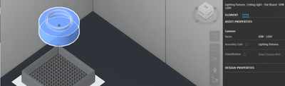

Hello jess long time no see.
a new issue
the doc was uploaded its in my facility but when i try to attach the doc to an asset
for example a lighting fixture catalog to a lamp . i cant.
because there isnt a link field in parameters .
"all discipline-> link to documents is not exist
youre tandem is gr8 you can assign links but look at mine
i cant.
please help me t assign the specific catalog to my light.
by the way this example i show here says that all of the docs cannot be assigned to assets
very bad.

jessica_smith
Hi @nir_arad_79,
There are a few steps that need to be done before you can simply attach a document to the element.
  1. Create a link parameter; click here to learn more.
  2. Assign the newly created Link parameter to all the classifications that need it in the facility template.
  3. Update the facility template for the facility that is utilizing it.
  4. Make sure all documents have been uploaded to the facility
  5. Attach the document to the element via the link parameter created in Step 1.
I hope that helps. After reviewing the provided documentation, please let me know if you have any questions.

nir_arad_79
yes as usual you help each time , and i succeeded with  your instruction to add a pdf to asset
