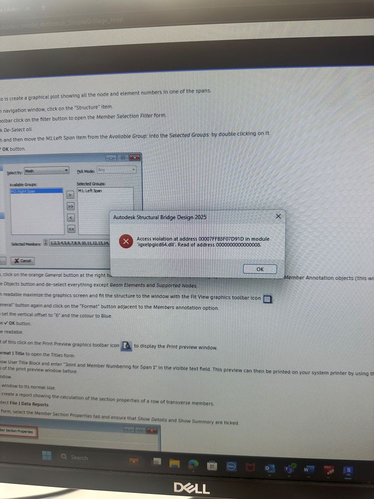

Hi, I keep getting this error when I try and create pre-stressed beams and now my grillage.
It happened when I was creating my grillage and now I can't open the file and I get 'An internal error has occured in file_to_bridge().'
Please help.

Hi
Has this always happened with Structural Bridge Design, or is it a new issue?  If a new issue, did this occur after installing a new version.  If so, what version?
The library mentioned is a OpenGL graphics library so it might be worth toggling your hardware acceleration option as described here to see if becomes more stable:
https://help.autodesk.com/view/SBRDES/ENU/?guid=2025.0_64-bit
This option was introduced in 2025.0 version.
