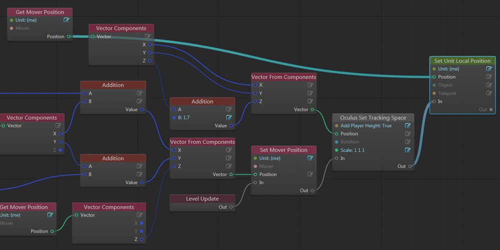

Dustin_Fike
Well, I was able to get the unit to move by adding a "Set Unit Local Position" node at the end.  See below.  However, it still doesn't rotate with the HMD.  I am not sure if I can and or need to get the mover and unit to rotate when I push the right thumbstick.  I can't find a flow node for getting or setting the Mover rotation like I can for position.  I still don't have collisions working either.

Dustin_Fike
Ok.  I got collisions working by using a "Move Mover" node instead of a "Set Mover Position" node.  So, the issues I was having are now resolved.  Now I have a totally new problem related to moving, but I am going to start a new thread for that one.  (The HMD position causes me to move backwards.)
