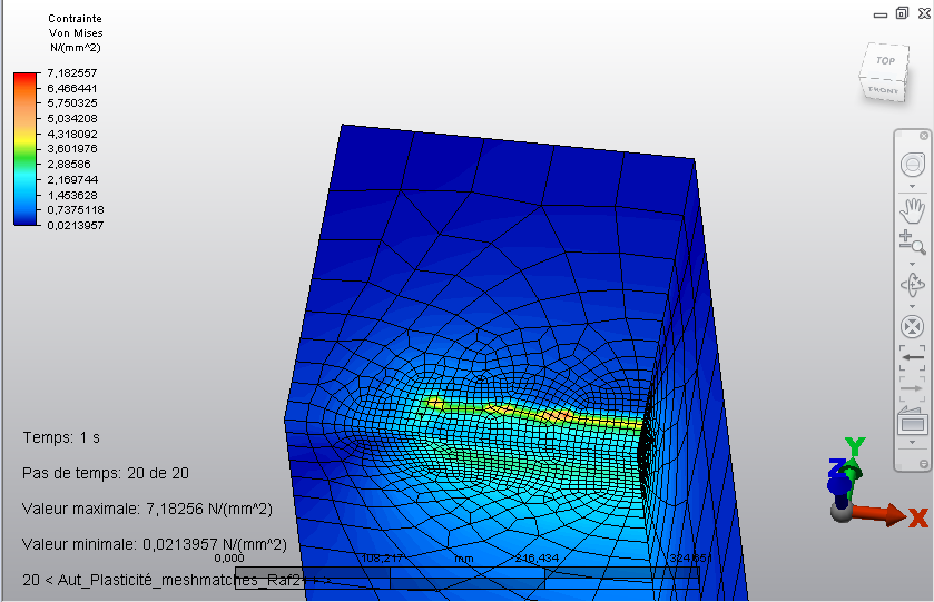

However I have realized that remeshing with matched mesh caused another problem for the surface contact with the ground.
when the meshes were not matched, I had an elliptical shape for the maximum stress on the ground. ( I think that's that's what the result is supposed to be) . However, now that the mesh are matched, the maximum stress are on a line relatively far away from the center, and near the edge, the stresses are quite low.
(to understand the images ; I reinforced the wheel by a thin layer of iron which is cylindrical and 5mm thick).
To understand the difference in the stress repartition,  i zoomed on the mesh and there is a zone where the mesh of the reinforcement comes downward, at an lower level than it should be ( I try to show it on the image I join). This location is exactly above the maximum stress on the ground.
I tried to remesh the reinforcement on this line ,so that the geometric irregularity of the mesh would disappear, but it just displaced it.
Is there a way to specify that one surface contact zone should have matched mesh and not the other?
Or should I keep the values I had on the first simulation for the ground ? However there is a huge difference between the maximum stresses; when the meshes were unmatched, the maxium stress on the ground was about 20MPa and with the mesh matched it is now 7Mpa

Is there a way to specify that one surface contact zone should have matched mesh ( in the wheel axis) and not the other (wheel/ground interface)?

At one time, there was an option, something like "don't match the mesh when not necessary", or "match the mesh when appropriate". The software know that if the analysis was linear and surface contact was defined, the mesh needed to match, but if it were nonlinear and surface contact was defined, the mesh did not need to match. So,
  • look to see if something like that exists under the "Mesh > Mesh > 3D Mesh Settings > Model".
  • Define surface contact between the wheel and ground before generating the mesh.
  • Define bonded contact between the wheel and axis before generating the mesh. (this will force the mesh to match)
  • Generate the mesh.
  • Define surface contact between the wheel and axle.
Another option would be to add a little bit of space between the wheel and the ground. This would prevent the mesh from "stretching" in an attempt to match the meshes. In the surface contact settings for the wheel to ground contact, define the contact distance to be equal to the space that you added between the wheel and ground. Essentially, you are using the contact to "fill" the space between the parts in the model.
Message 8 of 8
This option indeed exists and the solution you propose does work out ;
thank you very much for your answers ,
