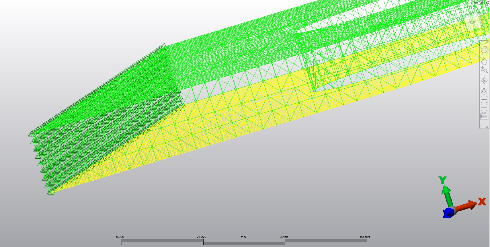

Hi Everyone,
I have simple plate which I have fixed on when end and apply a load to the other as seen in the image. (Okay I haven't included the load here.)
My issue arises when I mesh the plate, I seem to always generate a mesh on the surface of the object, however the mesh does not penetrate through the object see image below. My question is how on earth do you create a 3D mesh that penetrates right through the object not just a surface mesh that wraps around the plate?Surface Mesh .jpgw.

Stefan2653
Hi Nikhilmakan02,
I assume you have run at least a model check or performed a full analysis, which would have invoked the solid mesher. Once you have done that you can view the internal mesh in both the editor or results windows as follows:
Editor window: View/Object Visibility/Internal Mesh
Results window: Results Options/Show Internal Mesh
Stefan
