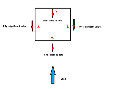

Reduced results for panels forces direction correspnds to panel cut loacal system (not global system of coordinates)
TRx is force perpendicular to cut line  in panel plane
TRy is force parallel to panel to cut line in panel plane
TRz is force perpendicular to panel plane
Refer to
Reduced results for panels in Robot Structural Analysis
TRz in reduced panels table represents shear forces in direction perpendicular to panel plane. For box/rectangular section loaded with shear force, loads are  transferred mainly by panels parallel to load direction. Those forces are represented by TRy in reduced forces for panels table. Results for TRz can be close to zero because panels perpendicular to load direction do not participate in shear forces transfer.
For load direction presented below  (horizontal direction of rectangular core wall) and horizontal panel cuts at panel bottom edges, I would expect
- significant FRy (non zero) values in panels parallel to load direction (1, 3)
- almost zero TRz values for panels 1,3
- almost zero FRz and TRz values for panels perpendicular to load direction (2, 4).

Yes I missed correct name . I had Nrx in mind
ad2
Yes. Horizontal forces (their main part) are transferred by walls parallel to load direction. It is like in member section. Shear force is transferred by web - vertical section part if you will load section with vertical load.
ad3. In my test model I am presenting expected structure behavior. Horizontal loads transferred by core walls segments parallel to load direction. I do not expect significant TRz values for core walls segments. They will be larger if you will remove core walls segments parallel to applied horizontal load direction
ad4.
I see that you have used material with shear modulus G equal to zero for walls simulation. You should obtain non zero (but still small) TRz values if you will change material to any of default material - with shear modulus G not equal to zero ( for example to C50)
