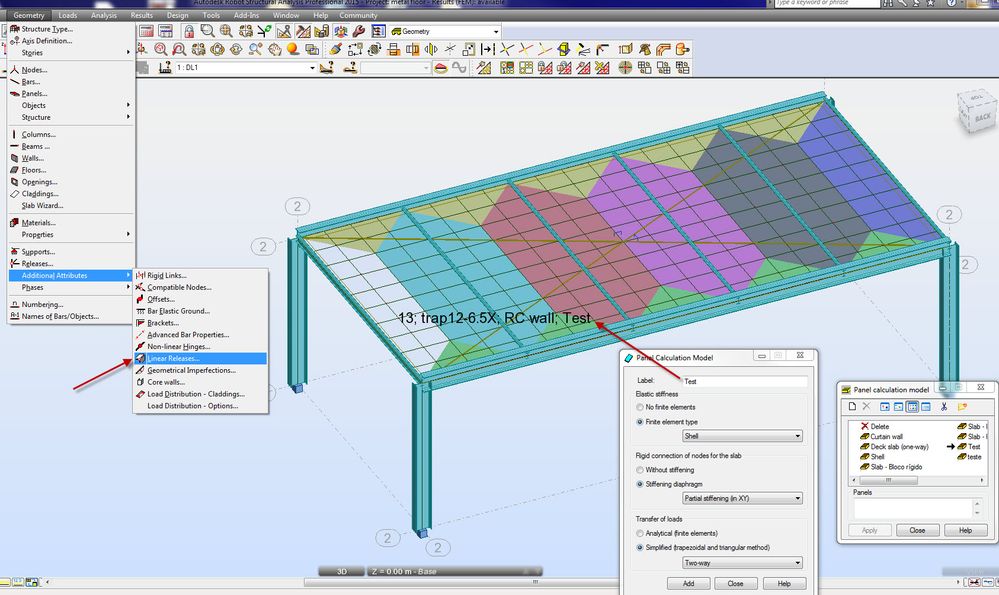

helo,
please see the attached image and file.
i tried to recreate a new clading and also a new panel. both created with the four corners of the outside beams.the clading distributes fine the load to purlins but panel dont. it does not seems right to break the big panel at smaller ones in each purlin. what am i mising?
thanks again!undefined
Rafacascudo
" Claddings are always "pinned" "
Not panels . If you use panels and want them to distribute load like a cladding you can do it using adjusting settings on " panel calculation model .
undefined
But if the span slabs are not continuous , of course, you´ll have to divide the " giant slab" into smaller ones and apply linear releases to one common edge.

helo,
tried to make some panel calculation models acording to your pic but here is what i found:
the only way to force it to do load ditribution (one or two way according to the last checkbox) is to choose NO FINITE ELEMENT type at the top.
if i choose FINITE ELEMENt no distribution is made.
i ended using my undefinedpics model for the flooring.please corect me if i am wrong.
how do you approach situations like that? is it nesessary to use finite elements? are the self weights and other properties of the given slabs or shels taken into acount?
in a floor like that , do you create individuals shels betwen purlins or what?
in the case you mension , can you please help with how to apply linear releases to common edges?
Rafacascudo
1st of all , your mesh size is too big. set it to 0,50m. Mesh the panel and freeze.
yes , it is possible to have finite elements and simplified transfer of loads. If you have temperature loads applied to the slab , finite elements are mandatory.
In the same picture(taken from your model) , there´s the place to create linear releases ,if you need them.
undefined

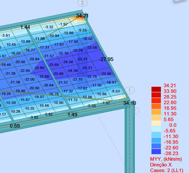

yes, the load distribution  shows fine with the collor diagram BUT it seems that the perlins eventualy does not take any load.
here is one purlin without finite element option:undefined
the 59knm seems right since there is a 10KN surface load at the mesh and the purlins distance is 2m .span is 5m so MY=20*5*5/8=62.5 (the diference from 59 i assume it is from offsets?)
here is the same purlin with the same situation and load if i choose the finite elements at the panel calc model:
FZ: ??
undefined
undefined

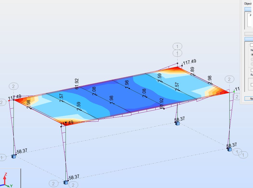

Also , here is the complete model without and with mesh option at the panel model:
undefinedundefined
Please note the BIG diference in MY 's  of the main frame.
why that?
 shouldnt the MY with or without the panels finite element at the main frame will be the same?
both senarios have the partial stifening XY. only change at the model is the Finite - No finite
If the purlin eventualy does not have distributed load from the panel, where is the small 3.22 MY  comes from?
is it from the deformation of the panel that it is suported at the perimeter main frame (not purlins) and eventualy "sitts" upon the purlins?
thanks!!

Rafacascudo
Don´t forget the moment resisted by the slab if you choose finite elements
undefined
If you make a 2meters panel cut at the middle of the span you´ll get an integral moment of 47.57 kN.m
undefined
add the beam moment and the effect of the beam offsets and you´ll have aproximately your hand made / no finite elements  moment valor
serrilated Fz and My beam diagrams are typical in models with beam offsets
