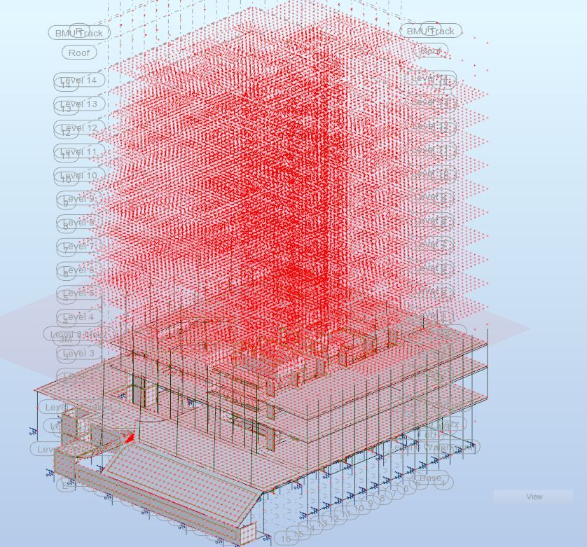

When using view planes, the elements which are not visible in the view, the points of those elements are still visible. Is there any option to make those point invisible too? Without turning off the calculation model (finite elements)?
Example: I have modeled a 3 floors building and when I reduce the z-z section plane to show only the 3rd level, the points of the other 2 floors are visible but not the panels. I have 0% transparency.

View/Display/Nodes , mark "hide nodes"

I also have this problem. The suggested solution hides ALL nodes where as I want to still see some nodes, but hide others beyond my view section planes. The view section planes hides all other items such as bars and panels but the nodes are still visible.ADR.JPG

Hi @Anonymous
Corrected in the Update 1 for RSA 2019
