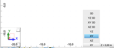

Hi guys,
Can someone let me me know how to activate the numbers in the x and y axis?
Also the small dots in the working windows doesnt appear.
Thanks.

On menu View/display/view , mark/check "Grid"  and "Ruler"

You have to switch to 2D Plan view.  The ruler and grid is not displayed in 3D view.
