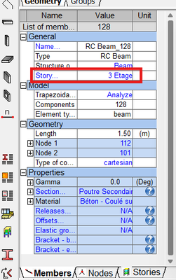

is there a way to get the storey name of an element (bar) that I already get, i'm trying to get the force that belong to that bar and output them in Excel, but also i want to add a column of which storey that bar belong to, I'm looking for something like this
Dim storeyName As String
storeyName = bar.GetLabelName(I_LT_STOREY(name or label))
is there a way or i have to iterate through each storey and then put the bar code

WALIDGIO
Hi @Stephane.kapetanovic
Thank you for the replay, I think there is no proprety concerning the storey for a element yet, I thought i was Implemented after all these years, so we still need to worked around
what i really want is to retrieve the storey of element directly without compare it, or get it from a group of selection.
like in this picture the bar proprety has a story that it belong to
hi @WALIDGIO
This is a request you should make to the Autodesk team.
As explained, the suggestions presented here are intended to illustrate the capabilities of the Robot API. They are not necessarily tailored to your specific architecture and are shared as general-purpose usage examples, rather than definitive solutions for a particular or personalized implementation.
Regarding the use of the RobotBar class and the addition of direct-read properties from RobotStorey, I have a different point of view than changing the paradigm. The code provided consists of just a few lines and is based on selections made from text strings, which are very quick to process compared to some collections. overloading the bar class with properties that are only occasionally read is not ideal.
Instead, you can optimize access times in your code by better data management, changing your programming language, creating your own classes and parralelizing your queries. This approach would preserve the API's efficiency while allowing for the customization you need.
