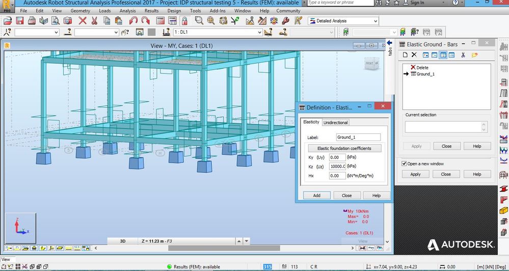

I drew my house's structural drawing in Revit. After that, I sent that model to robot structural for calculating reinforcement needed. After I inserted all the loading and run the analysis for beam reinforcement, it popped out " selected section is not supported, the section will be replaced with rectangular section". When I tried to analysis the ground, Robot itself will automatically shut down. Can someone help me?

mustafahesenow
Hi @Anonymous
Just go to Geometry tab then additional attributes then bar on elastic ground
then specify the kz , hy , Hx
then apply on the beams then make calculation and take it to design it will work.
I already tried it on your model and its work .
Mustafa Hesenow
Senior Structural Design Engineer/MZP
LinkedIn
Message 6 of 9
Hi, @mustafahesenow thanks for your suggestion. 🙂 However, I am still not quite sure with your solution because I am the beginner only.
May I know am I at the right track? If so, what value should I input in it? What is the reason of adding the attributes? robot problem 1.1.JPG
