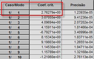

For a global buckling analysis ,you can do a buckling analysis. I did it considering only the self weight load case . The 1st buckling mode is of course the expected one (Top chord lateral sway)and gives a 2,76 critic coefficient.

1- Both . You have to check all structure bars against the code of your preference . And you can use the  Robot buckling analysis ,for example , find a more precise out of plane buckling length for the chord bars.
   I suggested the whole chord lenght (41.06m) ,but seeing the buckling analysis results , it is giving around 16,3m for Lz in the 2nd mode , which is the mode cleary affects only the top chord. And seeing the deformed shape of this mode with its double curvature ,it appears that this value for Lz is not out of reality
Not very familiar with buckling analysis though . Maybe Artur ,Rafal or Pawel , could give us a hint if in this case the Lz value is a good way to determine a trustable  out of plane buckling length.
