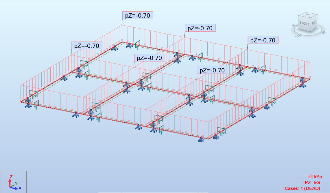

  1. I have created bars vertically and horizontally.
  2. Created cladding contour in between those vertical and horizontal bars, totally 6 cladding created.
  3. Applied surface load, pressure of 0.70 kN/m2 onto it.
Doubt is, when I display into load and its value Robot shows linear distribution onto the adjacent bars. But actually what I thought is it would automatically distribute as Triangular and Trapezoidal distribution to adjacent bars.
Why robot not creating Triangular and Trapezoidal distribution ?
How to create Triangular and Trapezoidal distribution onto the adjacent bars from cladding ?

Hi @Anonymous
See that:cladding.png
