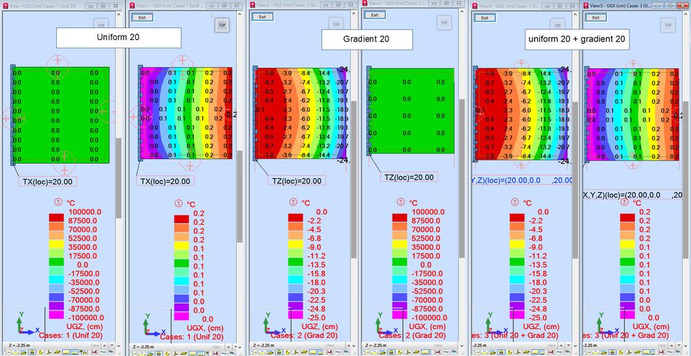

Rafacascudo
Sorry to answer on a "accepted solution" thread but
"dT1 is the uniform temperature (we can consider it the operating temperature)"
Just to be clear , dT1 is the dfference between the assembling temperature and the maximum or minimum (or any)temperature that place can reach on a given moment . dT1 ,if positive or negative will have a stretching or retracting effect on the structure plane .
Gradient is just the difference between the temperatures above and below strucuture plane , and will give a bending effect on the structure.
If you want to analyse just the bending effect dT1 should be zero.
Below a test model with a slab with one fixed edge  while the 3 others are free.
Case 1 uniform 20 degrees , case 2 gradient 20 and case 3 unif 20 + grad 20
Showing global X and global Z displacements for each load case
