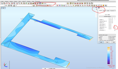

All the above testing took place in order to clarify the results of a model with non regular geometry. I have to design an corridor at the perimeter of an existing church, which has columns only at the external side and the roof is a cantilever.
(see pic 1)
The roof slab has a variavle thk 30cm-15cm from RC beam to the free edge. I followed your guidance, i switched off the reinforcement due to deflection etc.
What doesn't look right is that the elastic deflection  and the deflection taking account the creep are equal! So, what is the case? The calculation of the model for the church is not right?
at the model with the testing at the post above, the elastic deflection is 3.7cm and the deflection taking account the creep is 5.1cm.
To a slab that is supported at 4 sides, the ratio between elastic deflection and deflection taking account the creep is usually 1:3. Why the ratio here is so small?
More over as you can see at the pic below, there is a deflection of -0.8cm where the slab is connected to the RC supported beam. This is normal due to similar stiffness between slab and beam, or the connection between FE elements and Beam is not right?
I am sorry for the long post and thanks again for your help!!

Hi @TSOFA
Use tapered slab simulation with series of panels with uniform thickness.
Problem was discussed on forum couple years ago.
Refer to
Slab with variable thickness - wrong deflections
or
Slab with variable thickness deflection
Krzysztof Wasik

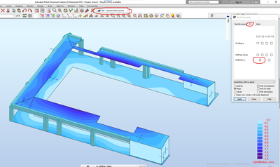

I did the slab with zones and the as you can see an area of slab has too high reinforcement. I understand that the slab at that area is narrow, but is not very long.
model: https://we.tl/t-L2xUhv1GTp

Hi @TSOFA
Switch off reinforcement adjust for deflection.
Krzysztof Wasik

Hi @TSOFA
In the previous model, the huge reinforcement of panel 110 was caused by activated Reinforcement adjust for deflection.
after Reinforcement adjust for deflection deactivation. Calculated reinforcement drops down
After
