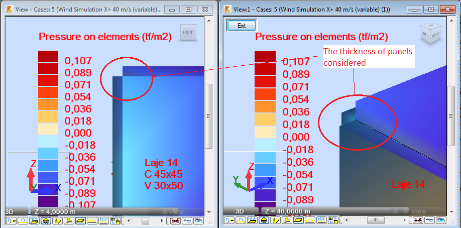

As concerns the effects in wind simulation discussed by and
1/ Differences between panels and claddings: both these objects are treated in wind simulation not as surface objects but as volumetric objects with some thickness. In case of panels it is simply the thickness of specific panel. In case of claddings it is fixed to 50millimeters. Pressures are generated on faces of these volumetric objects exposed to wind. During the final generation of loads the pressures on faces corresponding to thickness are neglected. So the real geometry, for which the simulation is run considers thickness of panels. It can be seen zooming with pressure maps displayed - as below:
So changing the thickness of panels or using claddings instead of panels changes the geometry of the body for which wind simulation is run and can influence results.
2/ Changing the direction of wind to the opposite one for symmetrical structure can result in change of results. These differences should not be very significant but in general case that cannot be avoided for the calculation engine used.

Rafacascudo
Hi Pawel,
I was pretty sure , you guys were looking after this! When the answer is not fast ,immediate ,as normally is , some investigation is going on...
Smiley Very Happy
I think that what we really need is a clear guidance on what we have to do to get this wind analysis done properly  with results we can trust.
- Opposite directions wind on a symetric structure should give  identical results. If this is not possible due to analysis engine , then which direction should we use ?
- Never came to my mind that the panel thickness would play an important role in the results. Should we use the real facade thicknesses or cladding is enough to get trustable results??
- 0,5% is good enough or lower values will give better results? Discrepancy in results can be huge  comparing 0,5% with 0,25% or 0,1% !!!
