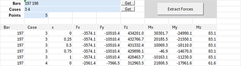

I am designing a steel structure with non-symmetric geometry, meaning the member local axis differs from the global axis. Naturally Robot provides the forces generated to the local axis. I need to export the forces based on the global axis for each member to a different spreadsheet that requires the moments and shear forces along the gblobal axis.
Is this possible  (My model as approx 500 members and 90 load cases and each member is checked along 5 points- this makes exporting from the forces table my only option)

although it was not specifically requested in your message, I thought you might find the following discussion thread useful. It includes programming examples for converting forces between coordinate systems, along with best practices for extracting force results. I hope you find it helpful.
https://forums.autodesk.com/t5/robot-structural-analysis-forum/uniform-moment-in-bar-in-local-coordi...
https://forums.autodesk.com/t5/robot-structural-analysis-forum/api-best-practice-for-capturing-bar-f...
Updated 08/08/2026
See also how to restore the local axis defined by the section itself ↓.
https://forums.autodesk.com/t5/robot-structural-analysis-forum/how-to-obtain-results-for-beam-elemen...
Here is an Excel workbook containing a ready-to-use macro; it queries the member forces for the selected elements and load cases, then automatically converts them from the local coordinate system to the global coordinate system.
