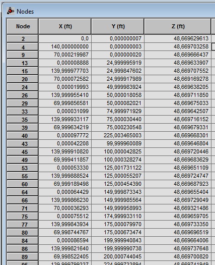

Diaphragm has not connected nodes on one roof edge due do model inaccuracies.
For example all roof nodes should have Z=48,67. But the are not on this level.
(Other coordinates are also not so accurate)
Run Detailed Correct for Whole Model to Structural Axes to correct geometry.
Corrected file attached.
You will not obtain the behavior like on figure 2 using diaphragm  \ rigid links.
