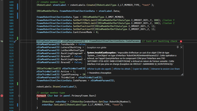

Hello everyone,
I am working with RSA 2021 and I succed to launch EC3 calculation like the following steps :
robotProjectPrefs.SetActiveCode(IRobotCodeType.I_CT_STEEL_STRUCTURES, "en 1993-1");
// create member type
IRobotLabel steelLabel = robotLabels.Create(IRobotLabelType.I_LT_MEMBER_TYPE, "Parois minces");
IRDimMembDefData frameRobotSteelSectionData = steelLabel.Data;
frameRobotSteelSectionData.Type = IRDimMembDefType.I_DMDT_MEMBER;
frameRobotSteelSectionData.SetDeflYZRelLimit(IRDimMembDefDeflDataType.I_DMDDDT_DEFL_Y, 800);
frameRobotSteelSectionData.SetDeflYZRelLimit(IRDimMembDefDeflDataType.I_DMDDDT_DEFL_Z, 300);
frameRobotSteelSectionData.SetDeflectionYZ(IRDimMembDefDeflDataType.I_DMDDDT_DEFL_Y, 1);
frameRobotSteelSectionData.SetDeflectionYZ(IRDimMembDefDeflDataType.I_DMDDDT_DEFL_Z, 1);
frameRobotSteelSectionData.CantileverMode = 0;
IRDimMembParamsE32 rDimMembParamsE32 = frameRobotSteelSectionData.CodeParams;
rDimMembParamsE32.TorsBuckOn = false;
rDimMembParamsE32.LateralBuckling = false;
rDimMembParamsE32.LatBuckMethodType = IRDimLatBuckMethodTypeE32.I_DLBMT_E32_METHOD_GENERAL;
rDimMembParamsE32.BucklingDiagramY = IRDimBuckDiagramE32.I_DBD_E32_NO;
rDimMembParamsE32.BracedY = false;
rDimMembParamsE32.BucklingDiagramZ = IRDimBuckDiagramE32.I_DBD_E32_NO;
rDimMembParamsE32.BracedZ = false;
IRDimThinWalledE32 rDimThinWalledE32 = rDimMembParamsE32.ThinWalled;
rDimThinWalledE32.Active = 1;
rDimThinWalledE32.TypeOfForming = IRDimThinWalledFormingTypeE32.I_DTWFT_E32_ROLLED;
rDimMembParamsE32.ThinWalled = rDimThinWalledE32;
frameRobotSteelSectionData.CodeParams = rDimMembParamsE32;
robotLabels.Store(steelLabel);
I tried to do the same with RSA 2023 but error coming the following line :
Do you have any ideas to solve it ?
Thank you in advance,
Regards
Louis

polylouis
hi @Stephane.kapetanovic
unfortunatelly it doesn't work :
Do you have other idea about it ?
Moreover if I comment lines 512 to 525, member type is created but like a timber type and not steel type.. Is it weird isnt'it ?
Regards,
Louis
using static RobotOM.IRDimMembDefDeflDataType;
using static RobotOM.IRDimLatBuckMethodTypeE32;
using static RobotOM.IRDimThinWalledFormingTypeE32;
using static RobotOM.IRDimBuckDiagramE32;
using static RobotOM.IRDimMembDefType;
IRobotApplication RobApp = new RobotApplication();
RobotLabelServer Labels = RobApp.Project.Structure.Labels;
RobotProjectPreferences Preferences = RobApp.Project.Preferences;
int code = Preferences.SetActiveCode(IRobotCodeType.I_CT_STEEL_STRUCTURES,
                                     "NF EN 1993-1-1:2005/NA:2013/A1:2014");
IRobotLabel Lbl = Labels.Create(IRobotLabelType.I_LT_MEMBER_TYPE, "Parois minces");
IRDimMembDefData LblData = Lbl.Data;
LblData.Type = I_DMDT_MEMBER;
LblData.SetDeflYZRelLimit(I_DMDDDT_DEFL_Y, 800);
LblData.SetDeflYZRelLimit(I_DMDDDT_DEFL_Z, 300);
LblData.SetDeflectionYZ(I_DMDDDT_DEFL_Y, 1);
LblData.SetDeflectionYZ(I_DMDDDT_DEFL_Z, 1);
LblData.CantileverMode = 0;
IRDimMembParamsE32 MParams = (IRDimMembParamsE32)LblData.CodeParams;
MParams.TorsBuckOn = false;
MParams.LateralBuckling = false;
MParams.LatBuckMethodType = I_DLBMT_E32_METHOD_GENERAL;
MParams.BucklingDiagramY = I_DBD_E32_NO; MParams.BracedY = false;
MParams.BucklingDiagramZ = I_DBD_E32_NO; MParams.BracedZ = false;
IRDimThinWalledE32 rDimThinWalledE32 = MParams.ThinWalled;
rDimThinWalledE32.TypeOfForming = I_DTWFT_E32_ROLLED;
MParams.ThinWalled = rDimThinWalledE32;
LblData.CodeParams = MParams;
Labels.Store(Lbl);
RobApp = null;
Stéphane Kapetanovic
don't forget to click the Accept Solution button and leave a < like !
Message 8 of 11
polylouis
It works if I call it at first ! 🙂

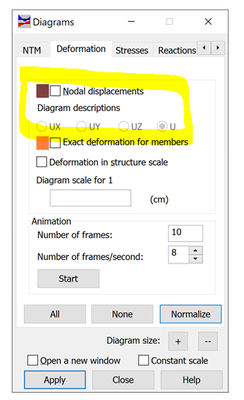

I have an other question : do you know if nodal displacement views are implemented by APY ?
Regards
Message 9 of 11
hi @polylouis
I haven't compared the APIs, the enum IRobotViewDiagramResult Type seems to be the same so only U would be implemented out of the new dispatch possibilities.
Stephanekapetanovic_0-1673450436945.png Extract
Best Regards
