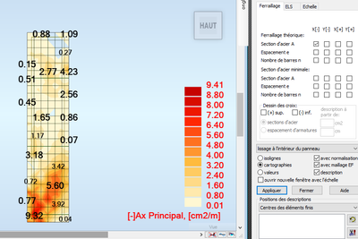

Can anyone know how module Robot in panel calculation can calculate the reinforcement only ? I use the Panel module but the result for crack and deflection is nothing.
I don't know is there any thing missing in my calculation.
In this case only the flexural reinforcement is shown:
But the crack and deflection is none ?

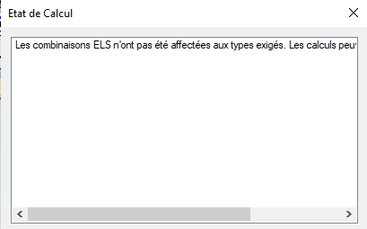

Yes I have defined the SLS combination (201), and both ULS (101) & SLS (201) is defined in the calculation of panel as shown in below:
But only the value in ULS show the results, for SLS it will appear this error message and the value is zero for all.

You should assign correct SLS type:
Or in the table:

I have tried to change to SLS-Quasi permanent but the result is still zero the same as below.
Did you check on the model on your side ? Does it have the result ? Thanks in advance

Maybe the reason is that you have a span 1.1 m and 200 mm slab thickness. For example, I have applied supports to have the bigger span:

I think so, I try like you proposed and they have the result but not same as you. And for crack width still has no result

You have too small loads to obtain cracks for defined slab geometry and loads. Cracks appears when you increase loads in your model. I have increasd live loads to 150 kN/m2. Then X- cracks are 0.2 mm.
